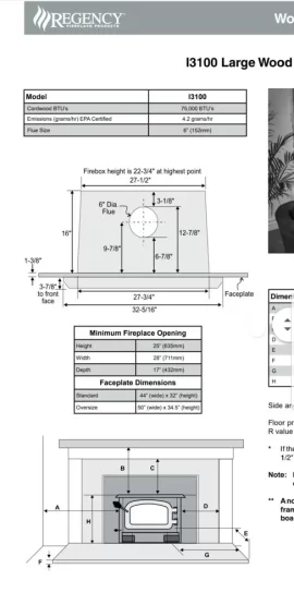

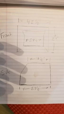

Hello all sorry for 100 posts today. I'm going to look a a used Regency i3000l and want to be sure it will fit my fire place. Hes some measurements I took
  • [Hearth.com] Will this stove fit

I found this on there website but can find anything on how much clearance is needed around the back of the stove
It doesn't need any clearance from the back of your firebox
