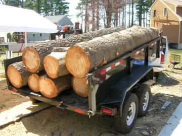

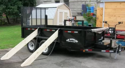

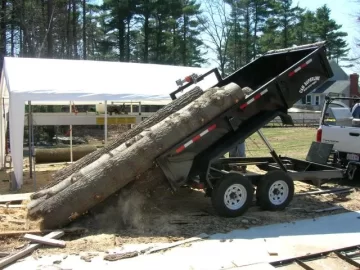

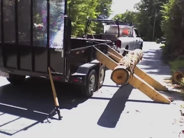

Yup, I do. This is how I haul logs for my sawmill. The winch cable runs over the log, back under it, and back to the trailer. It basically rolls the log into the trailer. The ramps on the side are capped on one end with steel and a couple trailer hitch pins hold them to brackets I welded to the sides. I've loaded 30"+ diameter pine (10' long) with this system.

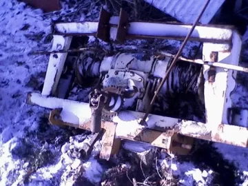

My buddy gave me a winch he had laying around that came off an old tow truck.
It's actually two spools that work off the same unit.
They are independently controlled with three positions handles.
One is to power in, one to power out, and the third position lets it freewheel.
I had a three point hitch bale spear I didn't need so I cut the spear off and mounted it on that.
I welded a universal off a pto shaft to the drive gear and cut down a pto shaft to fit.
It was only a couple hours work and it is, without a doubt, the most useful thing I ever made.
One spool has about 150' of cable which I can drag into the brush, a tight stand of trees, or to a leaner.
The other spool has about 20' of cable I use to hook trees to after I drag them out.
I can then use the three point hitch to lift them off the ground to keep them out of the dirt.
I drag four to six good size trees with very little effort and usually have one bucked in two, on the front forks.

James- Here's a picture. I took others but the wife's hand me down cell phone doesn't take good pics.
This shot is from the tractor side. You can see the pto universal welded to the original drive gear and the short pto shaft underneath it. You might be able to make out the spools on either side on the back of it.
Sorry, it's the best I can do right now.
If you're winching a large tree, it may want to pull the tractor backwards.
In that case, you can hold the tractor with a front loader bucket, set the parking brake, or park in a depression that the tractor won't roll out of.
In worst case scenario, I simply pull the tree out into the open and then it doesn't matter if I winch the tree to the tractor, or the tractor to the tree.
Lots of flexibility. I love it.

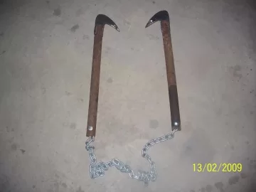

OH Ill pull rounds too if I cant/dont want to roll them. I made this to drag them with.. I was going to get tongs but they were $40 and would fall off if you loose tension on the cable.
