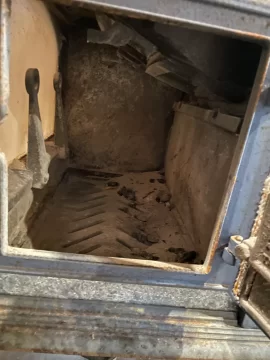

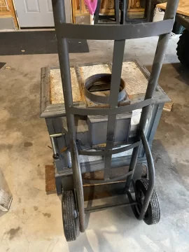

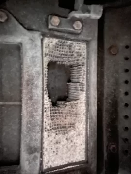

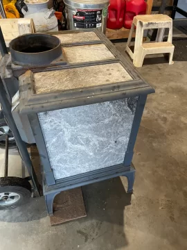

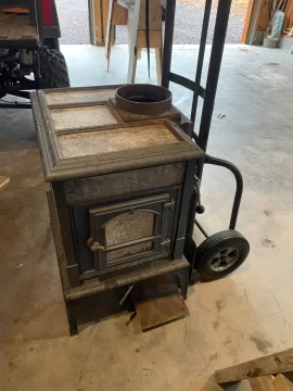

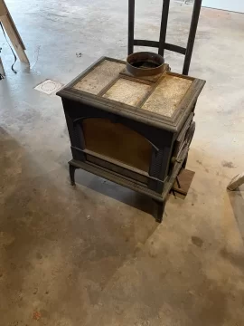

This popped up on FB Marketplace. Paid $300, needs the side stone replaced, new scoop, new cat, gaskets and a paint job.

Lol, that one needs a new cat all right!
Looks like a cat clawed its way through it! ;lol

Popped the top off

I haven’t totally taken it apart yet. I took off the top, scoop, bypass, andirons and glass. I’m having issues with two allen screws for the flue collar I need to drill and retap.
I just ordered the parts from Woodstock and most are on back order so I won’t tear down the sides until I get those. I did this before a long time ago and don’t have the old instructions anymore. I can’t remember how the innards were cemented. I’ll know more when I take it apart.
This stove won’t be replacing the Fireview it’ll either be sold or installed in my workshop. The Jotul 602 may be going into a mini cabin that we are looking at building on another area of our property.
The Fireview seams are fine and I have no problem with 12+ hour burns. At first there was some leaks around the door that cement has taken care of. Oh and that far back corner occasionally loses cement from splits hitting it but I just clean it up and push more cement into that corner if needed.
