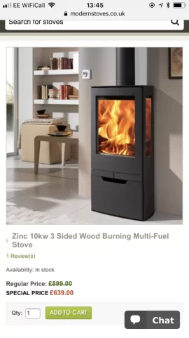

Any advice or suggestions would be greatly appreciated so I can sort the bloody thing out. I’ve attached the type of fire

I wouldn’t burn it without your baffle. How much vertical pipe off the stove before you go horizontal? Horizontal runs tend to lead to draft issue on startup. Try doing some really hot kindling burns with the door cracked till the flue gets heated up.
