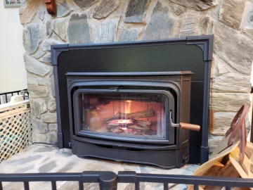

It’s fun, if that counts. If you like that sort of thing. I’m just south of Greensboro, about an hour from you I guess. You can install it yourself and save some cash if you want.
