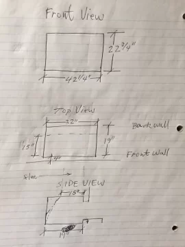

Fireplace dimensions are:
Front opening width: 42.24" W
Front opening height: 22.75" H
Back width: 32" W
Back height: 15" H
Bottom depth: 19" D
Top depth: 15" D

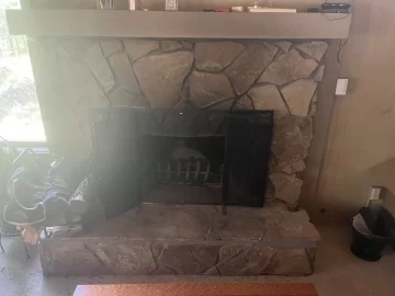

Here's a pic of the fireplace.

Plenty of clearance to mantel & adequate hearth for insert.

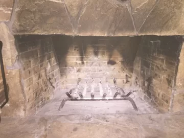

The 22.75" opening height is a limiting factor. For flush inserts inquire and see if the Regency CI2700 or Pacific Energy Neo 2.5 are available for installation by fall. The Osburn Matrix 1900 would also fit.
