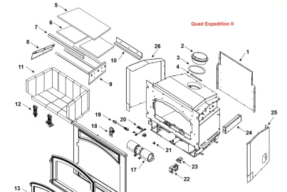

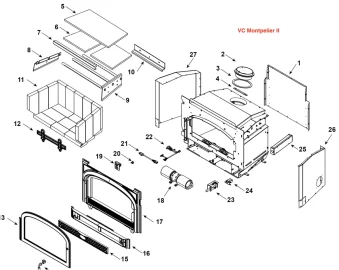

Both are HHT stoves. They appear identical inside with different window dressing and the Quad has the ACT.

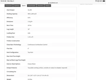

Hi, what is an OAK adapter and a static fresh Air intake?
OAK = outside air kit. The marketing blur shown means that the stove has a pipe stub on it to accept the outside air duct instead of a hole for which one must get an adapter. Many stoves have a 3 or 4" round hole that accepts a standard $3 start collar, but some require an OEM adapter which costs more.
So if I ask the dealer and they say that it doesn’t need it, what would be my answer them? Please forgive me, if my question sounds dumb, but it’s pertinent that I know the answer.
It depends. If the house is very tightly sealed then it may be necessary. Have you searched on OAK here? There is a lot of info and many threads. There is also a long discussion in the Sweep's Library in the Articles section.
