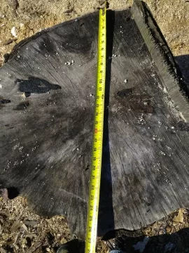

A lot of good advice already shared on this thread.
As stated previously, starting toward the outside edge, maybe 3 or 4 inches in on big rounds will make a world of difference. Slab off the outside and make it a square. Once you have a square, just keep moving in toward the center. You'll have long rectangular pieces, then turn 90° and split those into square splits.
I was working up some big sugar maple this fall that had been down for about a year and a half and using that method, it split pretty nicely. This was the base of the log with a bit of the root flare.
[Hearth.com] Wood chopping tips
