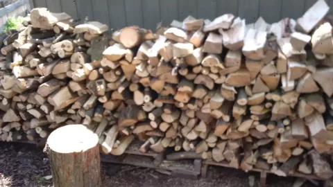

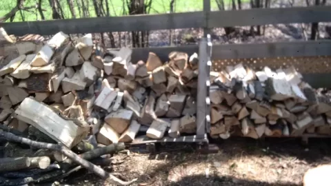

The wood in my pictures is currently maple. Not sure of what species. On Monday ill be looking and some fallen trees. A 30' fir/spruce and two more 10' trunks. Not sure how good fir/spruce is but it's free.
First photo is my newest pile. A mix of maple and ash. Second photo has my large splits on the left and a re-stack re-chop on the right. Taking everyone's advice and making smaller splits for better seasoning so I can burn this winter.

I think you will have good heat. You may have to keep the primary air on the stove open a little bit more and perhaps nay get a bit more soot in the flue but I would feel okay with this drying timeframe for maple. Either way, check after a few weeks if so of burning
Also, feel free to post your" creosote pics" after few weeks or so and get input on how you are making out.
