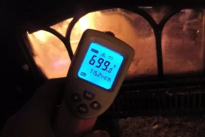

12 Redstone bricks in the Jotul C550
They increased my burn time compared to ash (not perfectly seasoned) by a good amount. Peaked out similar to BL but the last half of the cycle they didn't throw as much heat.
