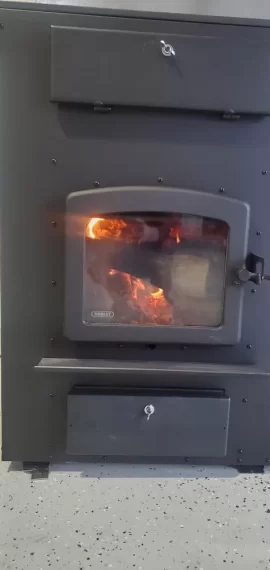

So I received the Drolet last Friday. I got it installed in my shop today. Totally cake walk! Some things I thought was nice. It came with a plenum, thermostat, and moisture meter! It is well built. Fit form and function is good. Built a fire in it late afternoon and my shop is 70. Which shouldn't be too hard because it was in the 60s in SW MO today. Tomorrow will be in the 40s and a better test.
[Hearth.com] Wood Furnace Help for Shop [Hearth.com] Wood Furnace Help for Shop [Hearth.com] Wood Furnace Help for Shop
Nice...but I have to wonder if having both units hooked to the same 6" chimney isn't going to cause some problems though...
