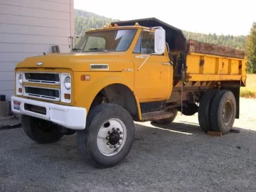

Thinking about this now...
  • [Hearth.com] Wood Hauler
