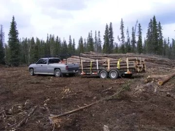

I vote for a trailer over a p/u. Trailer holds much more and is much more versatile/less expensive. If you buy it used it will probably retain most of its value.
What kinda brakes you got on that bike for pulling that trailer. :p
Sorry gzecc, just had to. But yes I agree, you can get away with more by pulling atrailer with a smaller truck. It will be easier on the suspension. Electric brakes are the key and stay within the ratings.
