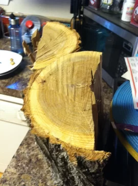

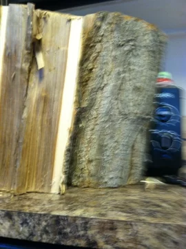

Bought a truck load of this wood for twenty bucks, freshly fallen, green.
Guy said it was elm, I have other elm and the color it different. Almost dark in center like walnut and this stuff split with a maul like a dream. My other elm was a pain.
What kind of elm is this and is it worth the price?

Really looks more like black walnut.
Siberian Elm. Much too light for walnut.
Reactions: jeff_t and HDRock
The split sure looks like walnut. Walnut would split easy. If it is elm it is Siberian.
The bark is not consistent with any black walnut I have seen. Another vote for siberian elm.
I could definitely be wrong.. as I usually am.. The bark is fuzzy and hard to see in the pics..

The interior I could agree with. Its that bark that tells me "no" to walnut.
A lot of dark heart wood in it says Siberian Elm. definitely not Walnut
That dark heartwood is super duper wet, and will lighten up to darn near white when it dries out some. Siberian elm, for sure.
