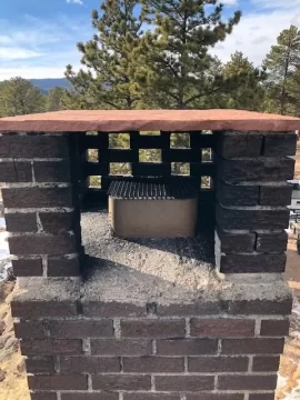

The previous owner had an old wood insert slammer in the exterior chimney without a liner. Removed that insert, had the chimney swept and inspected. Flue clay liner is 13 x 13 with a masonry shroud around the top (picture attached) which may make the liner installation difficult.

2. There is a 10 inch gap between the top of the flue clay tile and the top of the shroud (see picture). Is that enough room to get a liner down from the top? If so, would there be any more difficultly placing a mid weight flex liner vs light weight in the tight space? How many inch gap is needed from the top of the rain cap and the shroud?
