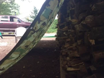

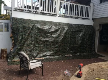

[Hearth.com] Wood is still getting rained/snowed on...help! [Hearth.com] Wood is still getting rained/snowed on...help! Tarps work if you do it right, I was in your situation last year, this year I said the wind and snow are not going to beat me.....I say double tarp it with brand new tarps ......
