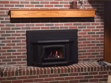

We are trying to decide between the two inserts for a 2nd unit. We bought the house exactly 1 year ago that had 2 open masonry fireplaces. One in the main level living room and another right below it in the basement. Shortly after moving in we installed a Mendota Full View on the main level. Love the unit, heats well and looks nice.
Now we want to put a insert in the basement. Considering another gas insert or a PE Super or PE Summit. The basement family room is about 25 x 15 that does L around off that some. My son also has a bedroom off the family room that we may or may not heat some. There is also a fairly open staircase to the main level with the door removed.
Will either provide much heat up the stairs to main level? I know with the open masonry fireplace that is left in basement not, all it does is drop my thermostat on main level. (I under stand why) I'm not trying to heat the whole home, but just wondering if one or the other will provide more heat up the stairs. Some rising heat would be nice. I know the PE inserts won't draw nearly the combustion air from the inside as the open fireplace, but wonder if the draw is does pull would prevent rising heat up the stairs.
