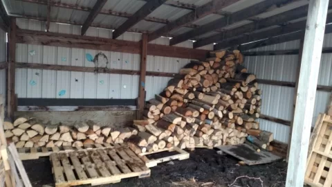

This is my current 'wood shed'. It's an old lean-to stable I guess, possibly was used as a wood shed before I moved here. It faces east.
It bothers me that the sides and back are all closed in. I'm concerned my wood will not season well without a proper draft. Is this an accurate statement, or should it season normally?
I'm wondering what my options are here. Since I've already got wood leaning against the walls, I'd prefer not to remove the walls and back and install 'planking'. I'm wondering if maybe taking a hole saw to the walls and cutting holes in it will help.
Leave it? Remove and install planking (and destroy wood stack in process)?
Drill holes/slats with Skil saw?

I love my woodshed . . . but I season my wood outside exposed to the sun and wind for a year prior before it goes into the woodshed. Any additional seasoning inside the woodshed is just that . . . additional.
For me the main reason for my woodshed is to avoid the hassle of dealing with a blanket of snow, ice, etc. and standing around in the rain and snow while loading up on firewood.
I built mine last fall and used free pallets for the sides so that there would be plenty of air flow. The disadvantage of that is that the snow blew through the slats and covered the wood. My suggestion would be to put a row of roof vents and the heat will force air flow through all the cracks and out the roof vents. Same thing at the top of the sides would work just as well.
I have two garage doors on my shed and I leave the doors open when the weather is nice and close them when wet. Air flow is vital to drying wood fast.
Remove whole sheets of the siding. (Unscrew) Assuming they are sheet metal screwed, remove back wall 1/2 way across. Looks like the ground is wet, so NOT GOOD.
Get gravel in there and build up the foundation. Open 1/2 of back wall for air cross flow. In the winter screw the siding back on.
I would still give green wood some time outside. I loaded green in a metal building one fall and that night and the next day the entire ceiling was dripping condensation, like it was raining. (with a dirt floor)
Now I stack everything outside, I have 2 steel buildings and 2 wooden barns and multiple sheds and all firewood stays outdoors.
Yeah, my whole county is mud right now... it's all clay and has very poor drainage. :( I have all my wood stacked on pallets. The roof itself isn't air tight (you can see sunlight where the roof meets the wall). I think I may look into adding slatted sides for better breathability. I don't mind the a bit of the elements getting on the wood, as this is all green and none of it will be burned until next year at the minimum. My outside stacks are all pine, and all of my seasoned stuff goes into my barn close to the house. This wood shed is out in my field that is inaccessible except by snow machine once snow hits. Unfortunately, I don't have one, just a 4x4 quad. On the bright side, my barn holds 14 cords of wood, and the basement can hold a cord or more. :)

If the prevailing winds hit the back of that loafing shed I would leave the sides alone and just open up the back. That way you get good air circulation. As Applesister mentioned you could always screw the back material in place before the snow flies.

Yes...dont damage the siding in case you choose to use the shed for something else. Dont drill holes in it.
You could put page fencing across the back opening to stack against but I would stack about 1' or 2' inside back wall and fill that puppy up...

With a roof over the main part of your stack, the wind blowing thru it 24/7 with the occasional rain will be an ideal setup.
Can you take all the siding off one or two sides and block most wind driven precipitation with the one remaining sheathed wall? Better airflow = faster seasoning.
If that floor doesn't dry out pretty quick I would be more worried about getting the pallets off the ground than fooling with the walls. How cheaply can you get used railroad ties?
I have no idea where I can even get railroad ties. None on craigslist by me anyway. I checked on the pallets yesterday, and they don't appear to be sinking, so that's good at least. Removing just the back should be a piece of cake, and will still give me walls to stack against. Good idea. I really have no idea what this thing was used for before I had it. If you notice against the back wall, there's plywood at the bottom. Its on a hinge, made to swing out and latch open. There's also another piece behind the stack on the right. I'm not sure what purpose the shed served beforehand. Years ago my home used to be a horse farm, so likely horse related.

I'd pull the back siding off and put slats up like a corn crib would use. If you are not familiar with that, basically you install 1" x 3 or 4" treated planks (or you could make your own by ripping strips out of a sheet of treated plywood) horizontally but you leave about 1/2" gap between the slats. The key is to cut the top and bottom of the slats on a 45* angle. When installed with that 1/2" gap between the slats, it allows a lot of air through but not much moisture unless the raining is blowing sideways. Obviously the 45s are installed so that you can only see the ground when looking out from the inside and you can only see the shed ceiling when looking in from the outside.
I think Oldman47 is right, that was a loafing shed, cow, horses, whatever critters you have, can go in there for shade and/or shelter if they want to when they are outside in the pasture. The bottom flap opens to allow better airflow when it is hot

Plenty of people on here prefer drying in a shed. A shed with open sides (hog panels to lean the wood against} keeps most of the moisture off while letting most of the sun and wind off. I do both but have come to prefer a shed due to not having to deal with snow.
If you don't get support up for the ends of the stacks that siding will remove itself all by itself before the shed is full.

I saw that too. I'd put some pallets against the wall standing on their edge, that'd bridge the gap between the framing and still allow air flow. Price is right too...

Those runners on the sides are a mighty long unbraced run. Just saying...

I thought that too. I'm not sure how I'm going to pull that one off yet. I think I'm going to end up needing to tear down these stacks. Slats are likely my best bet. :(
