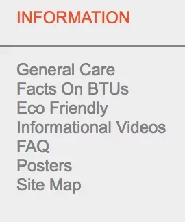

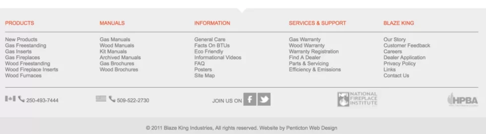

BeGreen...my glasses are yours for the asking. Look under information. See Test Reports?
There is no listing of Test Reports in the Information column. Magnified for your glasses, mine are prescription. :)

(broken link removed to http://www.blazeking.com/TestReports)
Refresh you browser or remove history. I logged on found it instantly.
