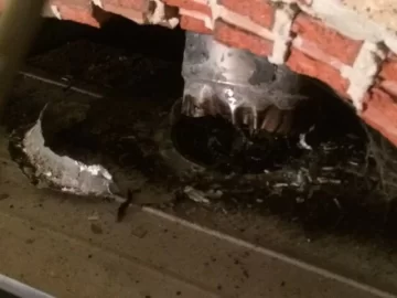

Here's a pic of the top of my stove. Not sure why there isn't a flue collar there but you can see the caulk broken away.
I think the sweep pulled the insert out bc I complained that I couldnt get a draw going with the insert and just proceeded to fill the house with smoke. I guess he wanted to check the connections? As u can see from the pic it looks like the previous sweep in February just pushed all of the creosote down the liner and created a blockage right above the stove.

It looks like a liner connector was put on, but it didn't fit well. That is a very heavy crimp in the connector that was covered up by metal tape. Metal tape does not belong on a single-wall flue pipe. It also looks like this install wants a 15 or 30 deg elbow.
