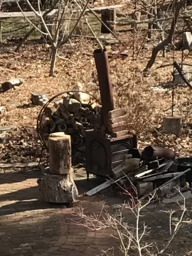

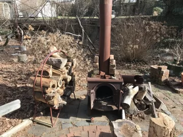

yes no brick needed for me. works great. well a few bricks to help prop up the single wall pipe.

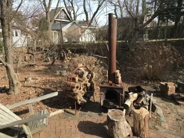

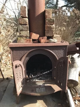

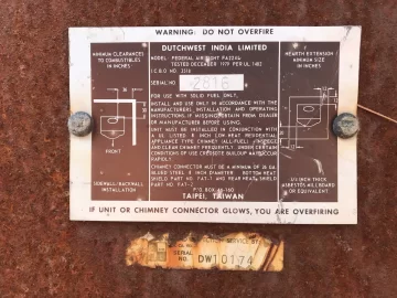

Federal airtight came to me rusted and busted maybe 20 years ago. Been out here ever since. Probably has another 20-30 years in it. Tag still looks like new. Ha.
[Hearth.com] Wood Stove, diy outdoor fireplace? [Hearth.com] Wood Stove, diy outdoor fireplace? [Hearth.com] Wood Stove, diy outdoor fireplace? [Hearth.com] Wood Stove, diy outdoor fireplace?
