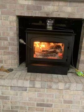

What about height from hearth to top of opening. Most stoves are top exit and too tall for what you are doing. I have something similar and have 29” opening height so going with Woodstock Progress Hybrid with short legs. Center of rear exit for the flue is 22.5”.
Reactions: awol42
33” from hearth to top. Were the short legs custom?
There are some 30" or less freestanding options like the Boxer with legs or the Inspire with the minimalist base.

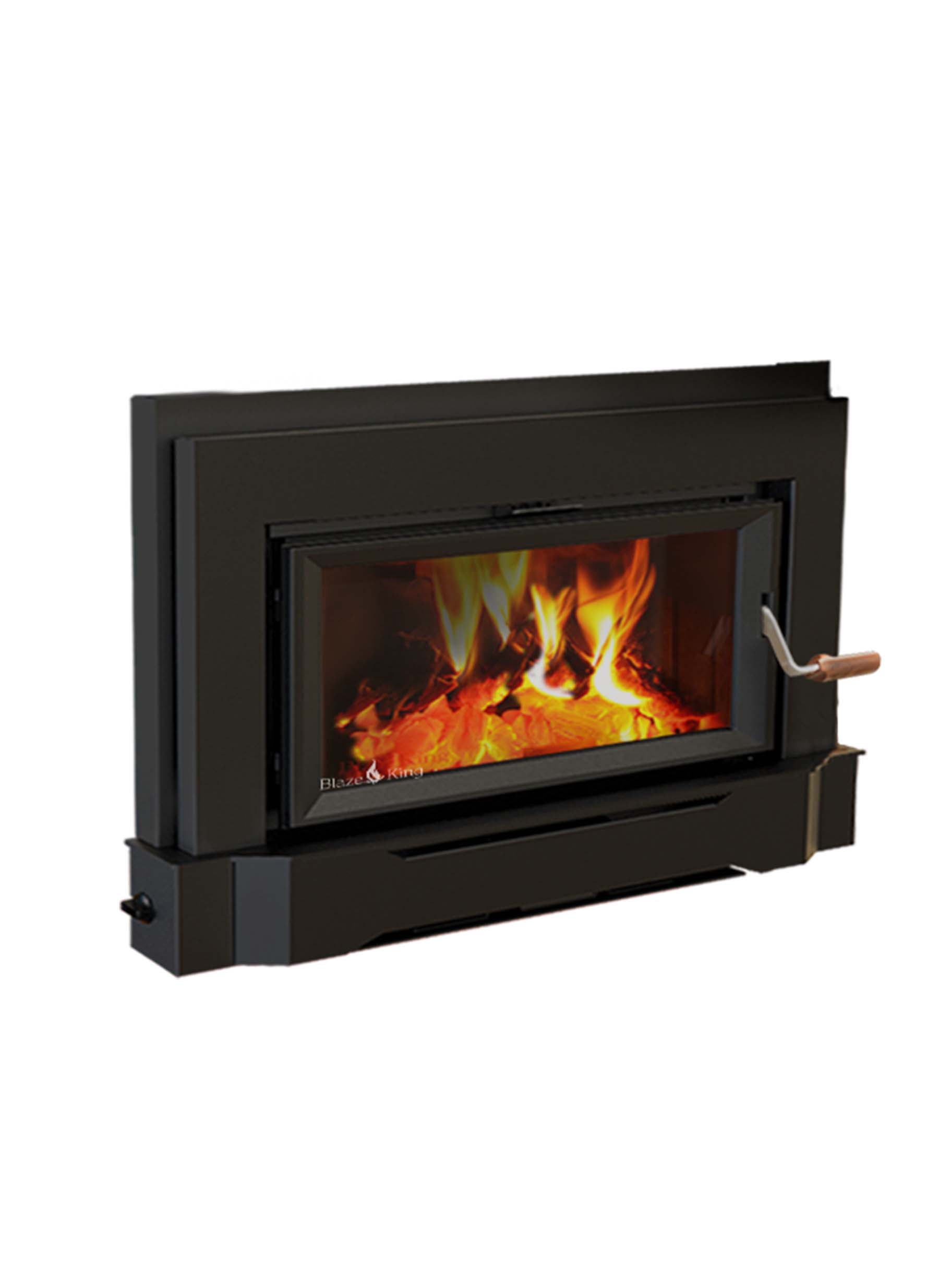

The Sirocco is available in insert configuration, which avoids the (indeed real) issues of a thermostatic stove stuffed into an opening.
To the OP, this is the one I am referring to:
Osburn, PE, and others indeed also make great stoves. BK is a great and reliable brand too. The description on the website is (in my experience, for my BK freestander) not oversold.
I would give this a second look.
I should have phrased this in another way: I would give this one a second look, not because it is better than the others, but because I think it was dismissed with an incorrect argument (and it is, as the other inserts mentioned, a great insert as well).

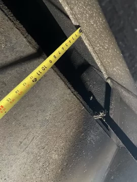

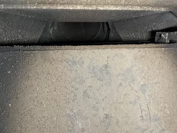

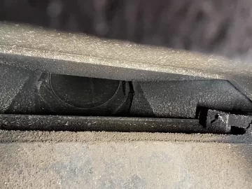

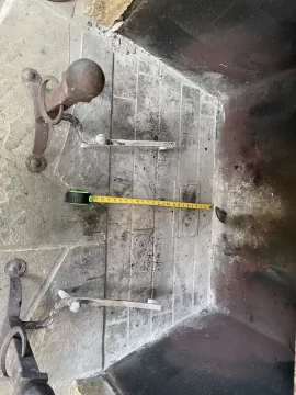

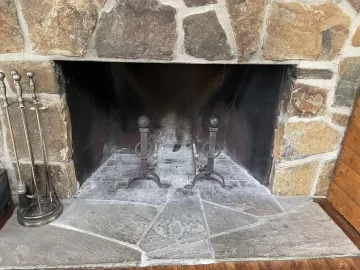

Can't say I have seen a setup like that before, got any pictures of inside the fireplace looking up at the chimney, and what kind of chimney does it have and how tall is it?
Have you checked with your Home Insurance to make sure they don't have any requirements you need to meet with that setup?
Pics attached. Not sure what kind it is. Room height is 12 feet, then insulation, roof, and 3 foot chimney out of flat roof.
