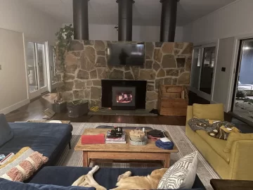

Hi Everyone - just thought I’d update that I went with the MF Fire Nova 2. I’ve been able to get in a handful of fires and so far it’s been great. First, the design is beautiful. So much glass. When the fire is really going it’s beautiful.
Second, I’m a wood stove novice but I’ve found this stove really easy to work with as long as you follow the instructions and you use good wood. The instructions are basically “be patient” to avoid smoke roll out. Wait 30 seconds between closing converter and opening door. Open door very slightly for 30 seconds and then open more fully. If you’re someone who likes playing with the fire (opening and closing the door a lot) this might not be the right stove for you. This is a load it and leave it stove. I can load it up and then not think about it for the next 4-5 hours. I haven’t done a full overnight load yet because the weather really hasn’t called for it.
Finally, their customer service was great too. Basically gave me a one-on-one tutorial for my first fire. It was really helpful.
Overall, really happy with the stove. Looking forward to colder weather (not too soon)!

Thanks for the update. It looks great there and the pup seems to approve too. When you get a chance, can you add a quick review to the Ratings section for the Nova2?
