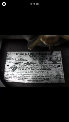

I have the option of both of these units and I don’t know which one to choose. I have a 1500sqft house I’d like to heat pretty much with just friends this winter. I live in the Northeast in the suburbs of Philadelphia.
Option one: The Earth Stove Bayview 400 wood burning fireplace insert with blower.
Or
Option two: DeVault Fab Weld Piping Company Old Mill Old Mill 55SI manufactured in August of 1981.
Both units seem to be in good condition.
