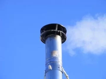

The cold weather you have months of sub zero temps with -51 is a real problem with that much double wall pipe out on that cold air. It will soot up / fill with creosote big time and fast inside the exposed above the roof pipe and at the elbow on the out side. And a lot of snow can make the hole thing come down in a sluff.
The fix is to build a chase around all the outside parts. This could be insulated to help keep the pipe hot. as long as you have the required clearances to every ting inside the chase, After you build the chase build a cricket to divert rain and falling snow around the chase.
Keeping the pipe inside the house clean will be not problem but when the north wind is holing and the nights are to long and way to cold you can not be on the roof sweeping out the exposed pipe.
Seriously , enclose the all outside pipe inside a well made insulated box called a chimney chase with a inverted V shaped cricket built next to it. A hot chimney is your friend, just plan to keep it hot.
@ -52c I will get ice build up like this. Thats it!!! I have 8ft of exposed chimney. I clean it once a year with the latest stove. The other was every two months. :coolmad: BURN DRY WOOD thats the key. If you purchase a stove with secondary burn non cat than make sure your getting it to run that burn on every cycle. Even if you have to open a window. That was my earlier mistake.
