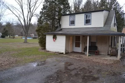

I am in the middle of purchasing my 2 acre piece of country with a tiny 1.5 bedroom house. I call it this because you have to walk through one bedroom to get to the master bedroom.
Anyway, I am super excited about having a wood stove in the house. I would like to try to use it like my pellet stove and have it so I almost never burn oil. Is this realistic? Because of this, I think I am interested in a new, safe, efficient model. Are these stoves safe enough to leave burning unattended like a pellet stove?
I read the "What stove should I buy" sticky and it sounds like I would be interested in a "no cat" stove. I'm not interested in having to change the cat once every few years I want this to be a "buy it forever" deal. I am trying to shop for a smaller model because I don't want to blast myself out of the house but I don't want it to feel underpowered either. What sizing would you guys recommend for this house? Any model recommendations? I don't have a lot of money especially after I'm done fixing this place up so I'd probably have to stick to the cost effective options. Englander comes to mind. The listing says the house is 704 sq feet but I haven't done the math myself. 40% of that is probably upstairs for the two bedrooms and bathroom.
I have attached a very rough floor plan I drew in 5 minutes as well as a picture of the house so you can get an idea of sizing and roof design. I was thinking of putting the stove at the base of the stairs in the corner in the dead space between the two windows. Would this work? Can't think of anywhere else to put it where it wouldn't take over the limited space.

p.s. I know the floor plan and the front of the house doesn't match up. Someone built a temporary structure enclosing the front porch and blocking that window. That's coming down.
I can't speak to the proper sizing of a stove for your home. I wonder, though, if placing the stove at the bottom of the stairwell would result in a lot of the heat going directly to your second floor? You could minimize that by adding thick portieres (heavy drape) across the bottom of the stair well; something that could be pulled aside when you want more heat to rise up the stairs.

Looks like a 2 cu ft stove would do well there. In non-cat I would consider the Pacific Energy Super 27 or their Alderlea T5. In cat take a look at the Woodstock Fireview or the Blaze King Sirocco 20 or 30 or the dressier Ashford 20 or 30.
For location, which works best A, B or C? I'm thinking C at the moment.
