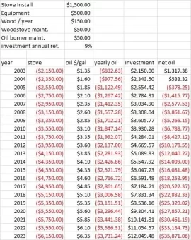

So, I've been thinking about how "frugal" heating with wood really is. I mean, are we really saving money? I wanted to run some cost analysis, for various scenarios, from the guy who buys an expensive stove and all of his wood, to the DIY'er with an Englander. I think the data is interesting.
For the case of the oil burner, I assumed $160/year maintenance (what I pay for my service contract), and used numbers for the cost of heating with oil, published by the U.S. Energy Information Administration (EIA). The first is a statement released recently that the average homeowner heating with oil in the northeast spent $2087 on heating oil last year. I also used the EIA for my calculation of historic (and predicted) oil prices, which has them increasing $0.25 annually, with an intercept of -$24.40 in 1900.
The oil burner then takes the money they were going to put toward getting started in wood, and invests it. I compared the growth of this modest investment, minus the cost of buying oil and maintaining the oil burner each year, to the costs of starting up and maintaining wood burning. The investment growth rate came from my own 401k statement, in which my rather conservative investments had 10-year averaged annual returns between 5% and 13%, with a net yearly return of approximately 9% averaged over the last 10 years.
First, the case of the DIY'er, who may spend $1500 for a low-budget stove, build his own hearth, and install his own chimney. I put $500 in equipment, because even if he already owns a chainsaw, this is the guy who will surely be shopping for a better one, after getting into this hobby. Equipment can also include, PPE, hearth tools, whatever. I put only $150 for wood costs, as this guy scrounges his own, and is only paying fuels, fluids, chains, and depreciation on his equipment. I assumed this guy has only $50/year maintenance, whether it be gaskets, catalyst replacements, whatever. I also set this guy's oil burner maintenance real low, as he's not the type to have a service contract with the oil company, anyway.
[Hearth.com] Wood stoves - true cost saving
So, this guy has spent about $6k on heating with wood, over a 20 year period. The guy who just kept his oil burner, and invested that wood stove start-up money has seen his investment grow to $12k, but with $3k'ish yearly oil bills, he's $36k in the hole. Heating with wood has saved this guy $30k over 20 years.

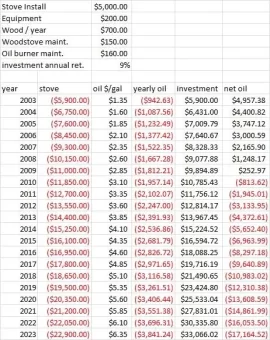

Scenario 2 is the polar opposite. This guy bought a new BK or Woodstock, had it professionally installed with a new hearth and chimney, and buys all of his wood. He also has a chimney sweep come out to service his stove and chimney each year. He does not need much equipment, other than a real expensive set of hearth tools, and a cheap Poulan from Lowes Depot. If he still used his oil burner, he would've had a maintenance contract on it, so that's figured in.
So, this guys investment has grown very nicely, because it was much larger to begin with. He's spent $23k on heating with wood (ouch!), while investing that money and spending the same $3k'ish/year on oil, he'd have been in the hole only $17k. Heating with oil would have been cheaper, for this guy.

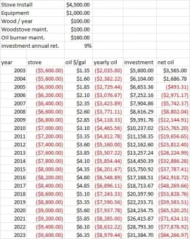

The third guy is me. I inherited one stove with the house, and bought a second used. I had two chimneys relined at a net cost of $3k. I use MUCH more than average oil (previous owners paid $7k in 2011, but I had it down to $5k yearly average, on last calculation) to heat this joint, but I collect all of my own wood. I bought three new saws, cant hook, and some other fun stuff, but also sold two good saws, when figuring my equipment cost. I buy catalysts, and do have a pro check my chimneys from time to time, and figure my maintenance to average $100/year. I had a contract with my oil burner co. at $160/year. The 401k is a little irrelevant (I'm already putting away the maximum allowed by law), but I'm assuming I'd find some other place to stick that start-up money at similar rates, taxes ignored.
So, I'll spend just shy of $10k to heat this place with oil for 20 years. In the same time, that start-up money would grow to $31k, but I'd be $84k in the hole after subtracting out what I'd have spent on oil. Not bad!
I'm sure no one will be shy at poking holes in my analysis. Let me know if you want me to run your numbers.

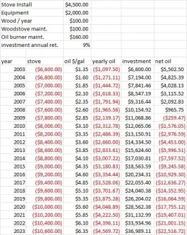

Hey guys... I wasn't stating there aren't other reasons for burning. In fact I've said many times myself, that I'd be burning if it COST me money, which so far (2 years in), it has! You're ignoring the point of the OP, and preaching to the choir, on other valid reasons for burning wood.
I also forgot the $1k I spent on a splitter, and the fact that I still plan on using somewhere close to $2500 gallons of fuel this year (even with burning two stoves), so here's the updated analysis for my particular situation. Small changes make big differences, extrapolated over 20 years.
So, I'll only save $12k over 20 years burning wood. Hardly worth it, in my situation, if I didn't enjoy the work and exercise.

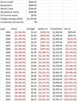

Here is my investment:
Stove $599 onsale
Misc hookup pipe $50.
Already had a nice condition masonry flue to use.
Already had a chainsaw.
Bought a wood splitter $900
Got $300 from Gov. Rebate program
Total cost $1249
Savings over electric baseboard heat $1200 - $1500 a year.
Investment was paid for in first year from the savings.

Not sure what you mean by "total cost", or what you consider your wood collection cost to be, but here's what I figure for you. Stove install is figured as $599(+6% tax) + $50 - $300.
The big inaccuracy here is that I'm assuming $0.25 increase in oil cost per year (normalized to your cost of $1350 for 2012), which is fairly accurate for oil, but perhaps not accurate at all for your electric heating cost. In any case, based on this, I see you as spending $5400 for 20 years of wood heat, versus $22,600 for your "oil". You'll save somewhere near $17k heating with wood for 20 years, versus investing your initial $384 at 9% annual return.
Once you get away from oil, my system is not accurate. In fact, since I'm not considering all taxes, etc., my analysis is not super-accurate in any way. But it's close enough to give some idea of where you land, in the grand scheme. The biggest factor seems to be the cost of initial investment versus on-going wood procurement costs (duh). A big initial investment favors putting it in a mutual fund and continuing to use your mainstream heating (oil,electric), particularly if you have to buy your wood. If you can do your install less expensively, and pay for wood with sweat and 2-stroke mix, then you can save upwards of $20k over 20 years by heating with wood. No great surprise, there.

You failed to compound inflation... it is not a linear additional cost every year but an exponential one. Also, it's hard to predict exactly where inflation is going, but since the Federal Reserve tripled the money supply in the past five years, it's a fair bet it's going much higher in the not-too-distant future. I don't see burning wood as superior in cost if you assume that inflation is muted and oil prices will never be impacted by black swan events. Instead, wood is a matter of self-sufficiency, so the return is measured not in dollars, but in peace of mind. You know that you'll be okay even if global war erupts in response to Syria or some other tinderbox in the Middle East or elsewhere or if global trade breaks down or if the currency hyperinflates or if government imposes crazy environmental laws on coal/oil/gas extraction, etc. Also as alluded to above, you pay income and sales taxes on your purchases of oil and other fossil fuels, but your labor to cut wood is non-taxable. And if taxes go up in the future, that's another variable in your risk equation. If you have a good stove, a chainsaw, and a reliable wood lot or other source of wood, then you have visibility into your future costs and risks. You don't have that with oil or electric or gas. This is especially important if you're on a fixed income or fear that you may be downsized at some point. The last thing you need is an inflated heating bill at the perfectly inopportune time. So calculating the savings (or costs) using a baseline set of assumptions doesn't really do much for me. Of course you do have to consider the possibility of no longer being able to cut wood due to injury or illness, and for this reason, wood burning remains a backup heat source for me along with propane, while solar is my primary.
I can make it real easy. All my equipment has been paid off years ago. Going forward...I save over 1000 gal of propane per year.
It's not that I forgot to include it, but that it really did not factor into this. Increasing oil cost is largely independent of inflation. When viewing the last 10 years the hard data used in this example, it's a fairly linear trend. The regression line drawn fits P = 0.25*D-24.4, where D = todays date minus Jan. 1, 1900. It's plenty close enough for the purpose of this analysis, as the simple week-week variation in price is way beyond the error in the trend line.
