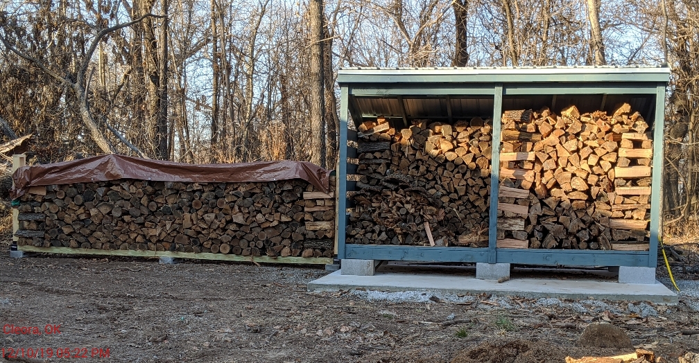

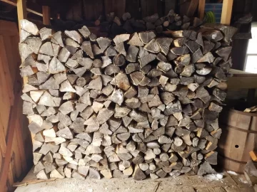

We've been burning some sugar maple that has been seasoned 3 & 4 years and we top cover the start of the second year. I've burned 1 & 2 year old seasoned sugar and there's a big difference.
I took a moisture meter to the sugar maple we've been burning this year and I'm getting readings of 12, 15 and 18 percent.

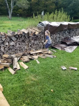

I see you had her blowing on the stack to dry it a little faster. ;lol

Are those tarps regular ones cut down to fit your stacks or are they the "special" firewood tarps that are long & skinny? What brand are they? Where did you get them?
The tarps I use are from Northern Tool. 18' x 4' tarps made specifically for covering woodpiles. Less than $4.

I burn mostly hard maple and 18 months doesnt quite get it there. I would also try to not have any tarp hanging down the sides at all.

Oh yeah, she roars.
Tarps are from "thetarpswholesaler.com". They are 4x20.
I just drive a nail and a small bungee to keep them on. I wish they had a 2 x 20.
I cut my pieces 18 inches, but might start doing two rows in pallets to get them up off the ground more and have less tarp hanging down.

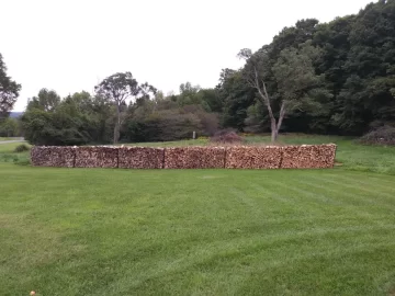

I thought this set up would season faster...maybe too tightly stacked

You are trapping moisture by covering part of the sides like that right away. Water condenses under that tarp everyday and drips onto the wood. I never cover until it has had a full summer in the sun...
Good to know. I will try to find a way to use the tarps in a way that doesn't cover the sides or, like you said, let it season a bit before covering. The tarps are only held by the end grommets, so there is wind flow under them as I have to occasionally pull the middle part back over the stacks when they get blown off.
