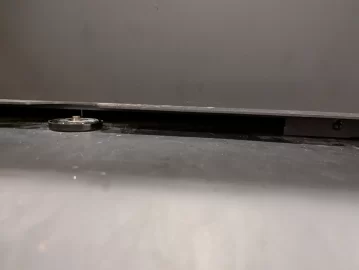

Post a picture of where the block fell in please...

Thank you.

Easy. There are two square drive #2 screws that can be removed to remove each fan set.
Once the fans set is removed, you can remove the blower exhaust. Shouldn't take more than 10 minutes.

Look closely at the image you posted. On the right hand side, look at the fastener, that is a #2 square drive. One of the left side as well.
