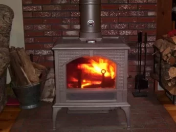

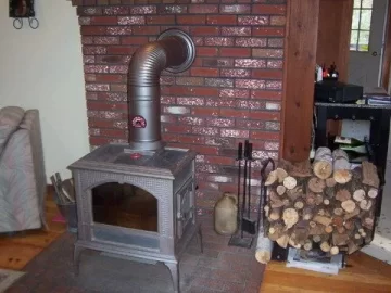

Here are some pictures of my Keystone with brown. I painted the stove pipe with their paint to match.
