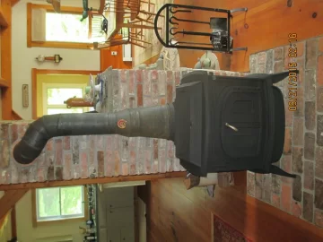

Can you post a pic of the location? It would be good to know what is the material of the back wall. 38" of depth is very low when factoring in 16" hearth clearance in front and some rear clearance. With a non-combustible wall behind the stove you could push it back further to gain some room in front. Even then you will have few stove choices without extending the hearth. I took a look at the Woodstock stoves but even the small Keystone needs a larger hearth than you have.

It is an 8 x 8 clay flue. The brick chimney goes up to the second floor and I can back the stove right up to the chimney. I can extend the hearth if necessary. There is a post in the left forefront not shown in the picture
