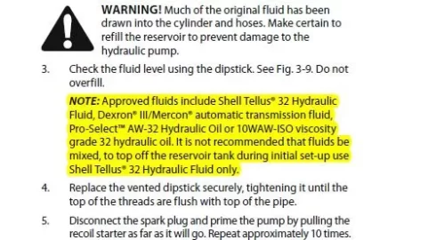

I've read the hydraulic fluid is very hard to come by for these brands. Do they come pre filled? Any truth to what I read? One of the reviews stated this and apparently the warranty is void if you use anything else. Even when topping off when new after the system is bled.
Just went to the Troy Bilt website. It appears that the fluid is included. It would not allow me to download the operator's manual to see what type of hydraulic fluid is used, but I know my MTD uses Dexron III, which isn't all that hard to get.
With that said, the cycle time on that 27 ton Troy Bilt is 19 seconds. That would actually have me crying. An entire minute or more to make 3 splits of the tough, stringy, stuff that requires a full stroke. Not to mention how long it would take to get the ram down should you retract it all the way. Last but not least, not sure I am a fan of the half I-beam. I would really have to take a close look at how that cylinder is held on (i.e., the welds and the pin that is used). I could not see this from the photos on the website.
From the owners manual for the LS27 TB splitters.

What a PITA if you have to top off the tank after buying it. I have no idea where to even buy Shell Tellus 32 hydraulic fluid. Would require a google search and some calling around. Just did a quick google search and nothing that would help finding a retailer around here on page 1. So, where do you get that specific hydraulic fluid? Equipment rental yard? Hardware store? John Deere dealer?

Thats what the reviewer stated about Shell Tellus. It could only be shipped and sold in 55 gallon drum for $550. From only one place he could find. Ugh.

Well I started with an empty tank so I was in the market for oil anyways. (mine holds a good deal more than 3 gallons too. About 3x that. _g)
Honestly, with the list of recommended oils in the manual that they provide, I'd just go buy some straight-up AW32 hydraulic oil and top it off. There's nothing sacred about that Tellus oil. Wouldn't mix ATF or motor oil in with it (long-term) but I'm not aware of any incompatible blends of AW32. ;)
I bought a gallon at Lowes of the I believe Pro Select AW32 oil for around $10.00.. It doesn't show up on their website..

http://www.lowes.com/pd_188583-30102-54012_0__?productId=1053693&Ntt=pro select&pl=1&currentURL=?Ntt=pro+select&facetInfo=
This is the correct oil they screwed up the description and specs on the website..

drain the damm thing and put something different in it.......that's total BS that you cannot get that stuff locally 1 gallon or so at a time. Total BS.
