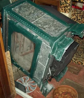

It definitely has been hot! I would for sure check out the secondary tubes and baffle plate, also take a magnifying glass and check out the joints on the side stones ( could have a small hairline crack that you wont see until it gets hot and opens up ). Also pull the rear heat shield and look for any cracks in the cast iron.
This stove suffered from a long term overheat. Meaning, it wasn't the guy trying to get instant gratification because a big fire in the soapstone stove that will just make the chimney hot. This stove was run hot for an extended period in an effort to produce heat or by accident. Nothing happens fast on a soapstone due to the thermal storage properties. That first hour blast from a new load or even a new fire will look impressive through the front glass, it will feel impressive to the chimney pipe, but the outside of the stove body won't heat up nearly as fast.
To prevent an overfire on a soapstone stove you need only monitor the stovetop temps with a thermometer and adjust the air control accordingly. You need to know the overfire temp per Hearthstone which is quite low and is available in the owner's manual for each stove. Otherwise these stoves are great for folks that are worried about runaways because they just don't do anything quickly. It takes a lot of effort to run one of these up from the normal 400 cruise temp to 500.
Oh and you will spend a lot of time with the air control completely closed. Mine purrs along at 450 with a full load and closed air control.
The back of this stove is all cast iron and has two firebricks inside the firebox in the back that are cracked. That isn't soapstone. They probably cracked just like mine did from inserting wood in the firebox. They can be easily replaced for a few bucks. I wouldn't jump so fast to the conclusion that this stove has been seriously overfired unless I visually inspected it. You cant tell everything from a few pictures. Yes the air wash is warped, but that doesn't mean the stove has been abused. I would ask for more info, like what stove top temps were run? What did they burn in the stove? How often did they burn? What do the secondary burn tubes look like? Maybe the airwash was a bad cast and is a cheap easy replacement. Who knows, I'd ask questions, take a look at it, and offer a couple hundred less if everything else checked out.

I just picked up the same stove, same color, for 100 bucks, the fire brick is cracked on the one I bought, just like on that one. The cracks will fill with ash, its not a hazard, unless it is actually "loose" and readily can be casued to fall in the firepit. They didnt even have a "deflector shield" on mine, it never had one as far as I can tell. They ran it for 8 seasons without one either way.
