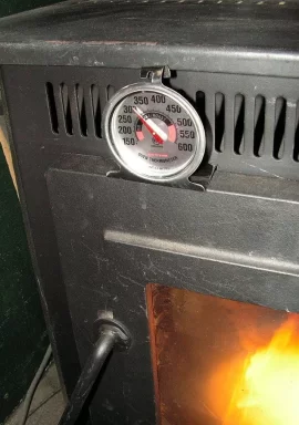

I've been getting 300F - to 325 F temps with a cheapo oven thermometer on my Englander 25PDVC on a regular basis running it on a feed rate of 2 and a blower speed of 2. If I run the blower on higher settings I get output temps of 150 - 180 F.( higher CFM). I burning those Home Depot Winter Warmth Pellets ( Hamers Hot Ones). On the warmer days lately, I've had to open a kitchen window to let some heat out as it's over 74-76 degrees in my house because it's just wayyyy too hot. My testing is nothing near scientific but it gives an idea of what temps you can get out of of what's available to we regular consumers! The quality and type of the pellets you burn is a deciding factor of what you get out in the form of heat. I've noticed a difference in heat output from different bags of these pellets( 2 different pallets of the same brand pellets) and how often and how thoroughly I clean my stove. Just my 2 cents1----Lorne.

It`s amazing that your stove doesn`t shut down on overfire with temps like that and blower running only at #2 . You are not utilizing the blowers ability to extract more heat off the exchanger.
You also can lower the feed rate on #2 for lower burns so you don`t have to open a window.

Hello, each stove brand runs differently and each is constructed differently so that temps have to be taken in different places depending on what make and model you have. If you post your make and model on this forum, there are a good bunch of very qualified members that can help you.
I'm just using a cheapo oven thermometer that I bought at Wal-Mart. You can use a turkey baster type of probe thermometer also.
Regards-----Lorne.
Cheapo thermometer here too!!
Hung it in front of one of the heat vent holes yesterday.
Getting 150F to 175F just maintaining room temp at 73F.
The flame is quite low. Will have to get colder so I can crank it up!!
It's a balmy 23F at 5:40 AM!
I also get 155-190 hanging a thermometer in front of the air holes but again , it means very little when comparing stoves or heat settings. Fan speed has a big effect on the temps.

I am running around 160-180 on # 1 setting
Hello
On My Avalon Astoria I get 235 Degrees on the lowest # 1 heat setting with Logik-e pellets made in Canada.
On the highest heat setting #6 it is over 600 Degrees which I only run when outside temp is below 5 Degrees!!!
I am using a temp probe in the heat exchanger tube to measure the temps.
However the IR gun right in front of the heat exchanger tube measures 240 degrees on the lowest # 1 heat setting so they are close!
The low heat setting above has a fan setting of # 4 and the feed rate is 1.7 lbs per hour.
