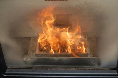

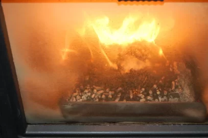

    Well, after 3 short bags...sigh. There is a problem that's NOT a dirty stove. The first pic is the stove before bed. The next pic is the full pot the morning after. DSC_0976.JPG DSC_0983.JPG

    Whether its dirty or not. Its an airflow issue.
    Bad gaskets, plugged stove, plugged vent, OAK obstruction, or failing Comb blower.
    Take your pic and attack that area.

    Something still not right here. I've never burned Turmans but my understanding is that they are very good. With the worst pellets I've burned in my CPM, the burnpot always cleans itself and ejects remaining ash during shutdown cycle. I do give it a quick hit with the vacuum when I do quick cleans perhaps twice a week, but the pot is always pretty clear...just a little residual ash.
    The picture makes it clear that there isn't enough combustion air.

    Well, after looking at your first burning pic above, I am pretty confident there is an airflow problem.....that sure looks like a lazy burn to me. The only things I can come up with at this point are a bad comb. blower, or maybe a leaking/not fully seated ash pan.
    At this point, I think you need to contact Mike H. directly and explain what you've done, and have him look at the pics too. Try a PM on this site (stoveguy2esw, or mholton@englanderstoves.com, or stoveguy2esw@yahoo.com), or call Tech Service back and tell them you need to talk directly to him.
    When you finally reach him, also mention what the other tech told you about cleaning burnpot after 1 bag of Turmans. I've never heard of anything like this before.....I haven't touched mine and it's been a week and 5 bags of Stove Chow.
