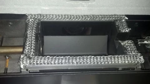

My CPM pot had no visible bypass, but I added 5/8" flat gasket as pictured above and experienced a noticeable improvement in flame characteristic and ash ejection.

......I added 5/8" flat gasket as pictured above and experienced a noticeable improvement in flame characteristic and ash ejection.
I too experimented with burn pot gaskets. I first tried using the 1/8" thick Lytherm. It worked well, but I hesitated actually adhering it to the cradle, seeing that it tears easily and I figured I'd be replacing it often.
I had a conversation with Dexter, and saw the above mentioned gasket he used. I happen to have some of that left over from my "Englander Early Bird Gasket kit", and installed it. So far, I am very happy with it, and would recommend this "mod" to the burn pot/cradle to any 10-cpm owners.....nice active flame.

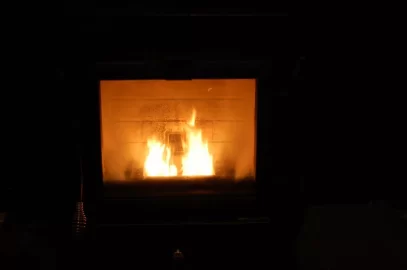

I couldn't wait the 2 hours. lol. The flame looks good! I noticed when I had the cradle and the burnpot out, that on the backside view of the burnpot sitting inside the cradle, it looked like the two corners touched, but there was a slight gap in the center. I also felt a slight rocking when I put my fingers on opposite sides of the burnpot that I hadn't noticed earlier in thread. Here is a photo 2 1/2 hours into the start-up. And things look and feel good!
[Hearth.com] 10-cpm dirty stove issue
What settings do you have the stove at when you took that pic? And that pic was taken AFTER 2 1/2 hrs of burning? That flame is WAY big!
Look at Dexter's pic above.....that's what mine looks like during normal burning on heat setting 5 or 6, and lower buttons at 2-5-1.

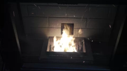

On 9-9 my flame doesn't get that BIG!!! There is build up already. I can tell based on flame size.
The flame should be much lower. Even on higher settings.

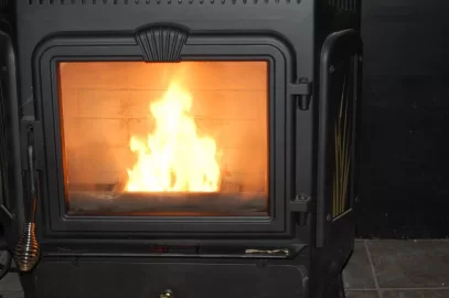

This is heat level 6. On 3-5-1.

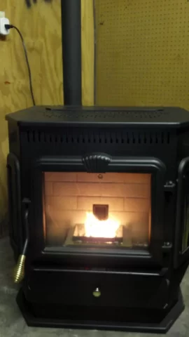

My settings are on 3-5-1
I'm running it on 9 9.

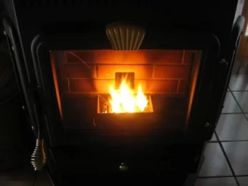

Here is a pic taken minutes before this post without the flash under different lighting. [Hearth.com] 10-cpm dirty stove issue
Now that I look at the first pic, I might have uploaded a pic from S U and mislabeled as after 2 1/2 hours.
