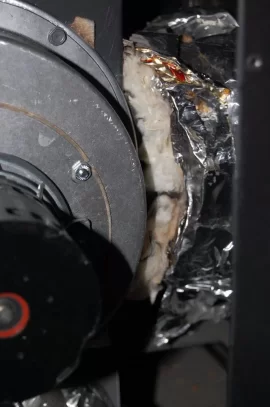

On the right side of the combustion blower there is insulation and aluminum tape. I'd say about an inch or two was pinched. There was a long piece of tape hanging. I bought some aluminum tape and re-taped it.

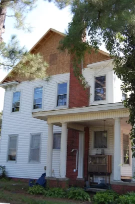

Might be a silly question but, could a very windy day have any effect on the exhausting ability?
Yes if you are venting into the wind and haven't made provisions for doing so.
It that what the swivel elbow is for? Is there any way of knowing what mph of wind it would take? This is my vent location. I need to go outside and look to see which way the exhaust is facing, and with 12mph wind?[Hearth.com] 10-cpm dirty stove issue
Any wind into the vent without a corresponding amount directed into the air intake will degrade the burn.
Horizontal vent terminations should be pointed down or face blocked or jet capped.
It that what the swivel elbow is for? Is there any way of knowing what mph of wind it would take? This is my vent location. I need to go outside and look to see which way the exhaust is facing, and with 12mph wind?View attachment 85852
Can't answer your specific questions, but the vent for my CPM is on the south side of my house, and the burn is definitely affected by the wind. It's very wide open and occasionally very windy here. Last night I was having issues with the burnpot wanting to fill up a little because I had a 30+ mph southwest wind. The wind shifted over night and all is well. I have problems with high winds (30+) but usually not anything below that.
