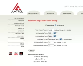

If you are using diaphragm expansion tanks remember the acceptance volume is what matters.
I would use a bladder type expansion tank. Also use the free sizer program at Amtrol.
Looks like a 132 gallon tank, 46 acceptance. It could be multiple smaller tanks, sometimes works out less $$

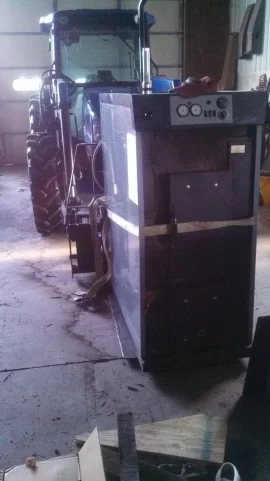

No install pics until late fall. And yes I bent the outer skin a bit. But it overall looks good. Even has a new tunnel installed.
I meant to say new nozzle. That ole' girl was heavy. It was 110 miles away. I didn't want to haul my 9000lb tractor all the way up and back. I knew I could haul the boiler on my pickup easy. Made a few calls, found a guy right next door....."oh yeah I can pick that easy with my tractor." Wasn't easy, damn near dropped it. But we got it. Scratched our heads a few times. Basically he started lifting and two of us helped lift by pulling on the forks.....its a wonder we didn't get hurt. But its home.
