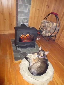

OK, fired it up tonight and it took right off, up to the 400+ degree range within 10 minutes. Whammo!
I think my early problem was that I was not putting enough wood in since I was worried about not exceeding 200F, then 300F for the break in burns. Now I actually need heat and we are cruising at ~450F with ease throttled down. So far I'm pretty impressed with how little messing this stove needs in terms of adjustment. The old VC Resolute I would be messing with all the time - close the bypass, increase the air, decrease the air, re-open the bypass since the temp dropped dramatically.
It's the first snowy night and I'm now feeling pretty good about this stove. Once it gets rid of the last traces of paint smell, it will be awesome.
(seriously, why can't the factories burn off that stuff before the stoves are crated. For a couple grand, they should run them through an oven before they get on the truck......)
...Make that 500F. This thing is cranking with very little effort. The old VC was not like this.
Houston, we have ignition!
Reactions: PapaDave
Pup sure likes it!
