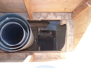

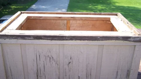

Here is a few more from the roof. Do you think this box could cause a problem for the new chimney?

Ok, I have to ask - what is that second chimney in there? Residual from some other appliance?
As to the box being a problem, as long as you maintain proper clearance from your new chimney (I assume you will be putting in a proper Class-A setup) which is usually 2" you should be fine. THe other thing I wonder about given what you said in other posts and the pictures is whether or not you have proper firestops in there (obviously not now!) that is something you will be needing to do - that other chimney may or may not be a complication for doing that right. That is one big hole you have there! I hope you don't get any rain before you get it all closed up.

As soon as my cordless drill battery is charged, I'm sealing the top off with a piece of osb and tar paper. Other than that, I'm done until I choose what stove to buy.
