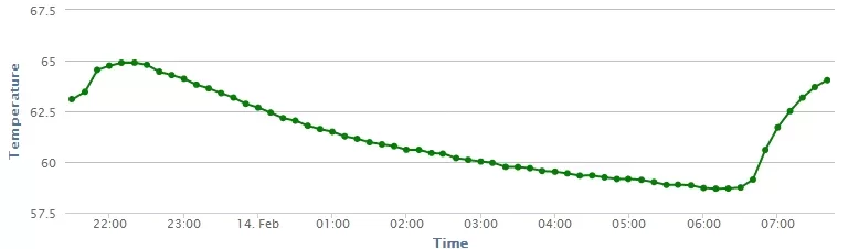

The house got warm very quickly this morning!
Last night I loaded it around 10 pm and set it to 1.25. The cat was in the inactive zone but the house did not even drop 10 degrees.
Added a couple fresh splits on top this morning and had to turn it down almost right away because there was so much heat!!!
Glad it is working better for you, but something still ain't right.
I agree, shouldn't be seeing a big drop like that over such a short period of time. A higher t-stat setting may help with that with it. If it gets the room too hot while you're in it leave it turned down and when you head to bed turn it back up.
1.25 is pretty low for the Ashford...........The lowest I have set mine is about 1.40.
Are you charring your wood pretty well on reload ? ( Good flames for about 10 to 15 minutes on reload ) And after you close your bypass and set your t-stat does the cat dial rise up to about the 11 o'clock position or more ?
Also , Did you get another t-stat from the BKVP ? He said he had one with him for you when he was going back east .
It might need to be replaced
Why is that? I turned the thermostat down for the night.
I'm pretty thrilled with how the stove is working now.
No. The dealer and I agreed that there was no indication that my thermostat was malfunctioning.
I do agree that charing the wood more seems to help.
The rest of my post did state a higher t-stat setting would probably help the temp drop. :) A stat setting near 1 for me this time of year is a no go, the house would be too cold for it's inhabitants. ;lol
Regardless, I'm happy to see the stove is working much better now. :cool:
