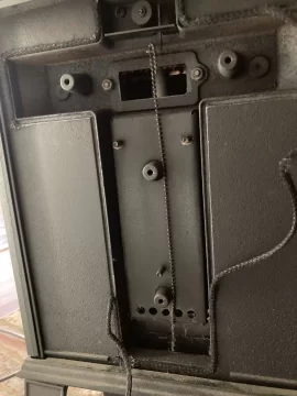

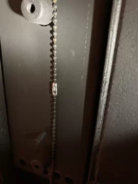

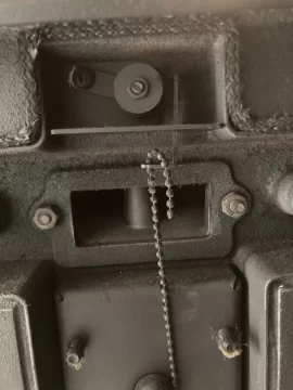

Today I added a link to the damper chain. I decided to cut the chain in half and add a link as opposed to mess with either attachment point. The thermostat mechanism does not seem particularly robust, so I didn't want to risk damage. The back cover rope gasket pulled out, but I was able to press it back into the channel pretty easily. I wouldn't remove the back cover again without a spare gasket on hand. Time will tell but I feel like if it was a bit too much length, I can remove the foil tape on the flap. If it is not enough, there is another hole on the damper I can cover with tape.
I also pulled the telescoping chimney connector pipe. It was really easy to do and didn't even scratch the paint. I was pleased to see there wasn't any creosote in the chimney system, just a light coating of brownish/grayish ash. The thermometer probe was enveloped in ash, but I doubt this had any negative effects. I cleaned it with a fairly weak household vacuum, being careful not to get too close and hit the super wool. The super wool seems super frail.
I plan on lighting a fully loaded fire later tonight to test the damper door, and since I am off work I can monitor for overall burn time as well.
Pics below:
[Hearth.com] Did I buy the wrong stove?[Hearth.com] Did I buy the wrong stove?[Hearth.com] Did I buy the wrong stove?[Hearth.com] Did I buy the wrong stove?[Hearth.com] Did I buy the wrong stove?[Hearth.com] Did I buy the wrong stove?
Thanks for posting pics as I've never been into the back of mine. That probe looks pretty good. Here's to hoping the damper is now able to fully close!

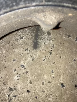

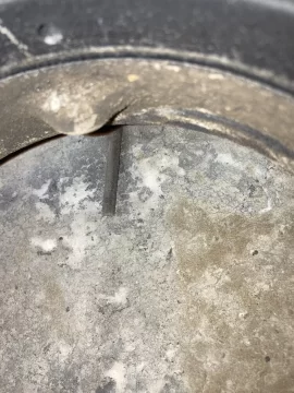

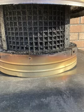

Last night's fire was an exercise in frustration, but fortunately things ended well. At about the 1hr/300F mark the fire kept stalling out. The damper was almost closed at 300F so I though my new adjustment was starving the fire for air. I decided to remove the foil tape from the flapper to give it more air. I do no recommend using foil tape! I ended up using a pencil to just poke a hole in it. I think a small magnet would be much easier to deal with for covering holes on the damper.
Removing the foil tape did nothing. I decided to prop the damper fully open with butter knife. I still couldn't get the fire to go! This has never happened. I sat on the couch feeling frustrated, confused, and wondering what I had done to mess up my stove. It was then that I realized that I must have some kind of obstruction because I kept getting smoke spillage when opening the door, which has never been a problem before.
Fortunately last night the moon was bright. One trip to the roof at 11pm confirmed my suspicions of a clogged spark arrestor cap. I popped it off and by the time I was back inside the fire was already going. Things seemed to burn well and eventually stabilized around 500F. At midnight threw one medium split in and it peaked at 750F and I went to bed. The stove temp was just below 200F and there was a small pile of hot coals in the back at 9AM! I'm counting this as a victory! I think the damper is closing between 300F and 400F but I'm not entirely sure yet.
I am still looking forward to doing a cold start to coals burn time test, but will have to wait a couple of days for cooler weather again.
When we first started using the stove we used a bunch of junk from the recycle bin to start fires. Cardboard, glossy mailers etc. I think I must have disturbed enough ash in the system yesterday finish plugging it up. Still crazy how it went from seemingly over drafting to clogged so fast.
Now to go clean this mess. Any suggestions?
I'd get a soot eater and run that in the cap. If you need it sooner, a metal brush (that you might have to trash after this...).
I have not read back the whole thread again, and someone surely said this before, but I'd check the moisture content of your wood. Too wet wood is cause #1 for what you see. And burning stuff other than wood, and burning too slow, and insufficient draft, etc. But all are exacerbated by wet wood.
And congrats on finding the cause. It can be frustrating. Next time you see these symptoms, you'll simply check up there first and fix it.
This (symptoms, and e.g. working thru wet wood) is all part of the learning curve. Work thru this, identify the problems, and change your behavior to avoid said problems in the future. That'll make you a happy (and clean) burner.
Good job. Keep going.
Reactions: bikeshopguy345
Often, or in my experience, that cloggage is bone dry crust and falls off pretty easily. Think potato chips instead of wet tar.
While you're up there you might consider taking that stupid filter off and throwing it in the woods if it is removable from the cap. You want a cap, but the filter's best purpose is for keeping birds out.
I probably will get a moisture meter before next season. My current white oak is 2 years split/stacked in the sun and wind and was standing dead 1 year prior to that. From what I can tell it is pretty good.
The screen brushed out pretty easily with a stiff brush. I am thinking using random junk from the recycle bin to start fires was the cause and I disturbed enough ash yesterday to finish the clog. I have a good stash of fatwood now so no more cereal boxes…

I picked up a moisture meter from Harbor Freight and it's given reasonable numbers so far - not that I have anything to compare it to, other than I've measured wood down around 13% and fresher stuff over 40%.
I leave the cap screen in mine due to critters and don't have anything other than a thin black layer on it. I use a little (and I mean a little - maybe a crumpled ball slightly smaller than a tennis ball) brown packing paper on the occasions when I'm starting from cold, doing a top down start.
I'd say coals 9 hours later is a huge improvement. I'm pretty sure you can still have decent coals after 12+ hours like I do once you really get things down. I think the only question for me at this point is if you will be able to get enough heat late in the fire, before reloading in the morning, to keep the heat pump from kicking on. As you've realized that's not the end of the world but now that you're getting coals later, you should be getting heat later in the burn cycle, too, so maybe you'll be able to keep the house just warm enough during that part of the fire.
