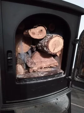

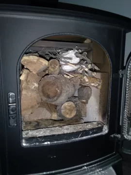

Here's how I typically load the stove. You can see the smoke starting from the pic of the reload onto coals I've raked to the front, and you can't quite see a couple more pieces hiding back in the dark at the top of the stove. The second photo is a typical top down cold start. I'd probably use a little more kindling around the paper now. Either will yield enough coals for a matchless relight 12 hours later.

Okay, you're about 5.5' taller than my setup, and I have single wall instead of double wall stove pipe. That will likely reduce your burn times some due to higher draft. For sure, it's good to be able to shut things down. I have a couple feet of intake duct and a blast gate out on the end, away from the stove, so I can get to it to shut it down if needed.
Of course I'm not getting hardly any usable heat after 12 hours, but if I still have coals and you don't, that definitely means you can do better and get heat output longer. Even an hour or so longer sounds like it might make a huge difference in your situation. I hope it would be enough to make the difference for your overnight timing.
View attachment 291976 View attachment 291977
Very nice. Thanks for the pictures! I plan on incorporating some round pieces into my future firewood.

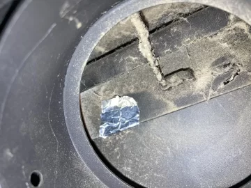

@wjohn I could not find a blast gate in town. I did however buy some foil HVAC tape and covered the circular hole in the damper flap. I couldn't believe how dusty the intake was. I vacuumed it out and brushed it the best I could, but it is still kind of funky.

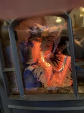

I lit a fire top down at 12noon and it was 41 F outside. At the 1 hour mark everything was burning nicely. I have a stovetop thermometer in between the cook plate and the flu outlet. It stabilized around 500F at the 1 hour mark and the flapper seemed to be about 95 percent closed. The secondary flames looked more blue/orange and slow as opposed to yellow and fast like I'm used to seeing. I think I am making progress here. I will report back later with any difference in burn times. Thanks again everybody.

Hmm. At that temp my intake flap would've been fully closed well before an hour. It should sit right up against the main plate behind it, so that the only air getting in is coming through the primary and secondary hole, not underneath the flap. I can reach around, remove my intake ducting since I have it fairly loosely attached, and feel the intake flap. On my stove at least, there is no movement after that much time into the burn - I can't push it closed any further because it's flat against the plate behind it, if that makes sense. If you can push on it and feel it move in a little more before stopping against that plate, I'd suspect the chain isn't quite long enough which would prevent it from fully closing. There was another member on here who seemed to be encountering that issue. If so that would reduce your burn time because it's not shutting the air down as much as it's designed to.
My secondaries turn mostly blue after probably an hour or so. I hope you were able to read through all of my install thread and the thread dedicated to the stove top temps... If not, in summary, I was concerned at first, and then later on not so much. Some of my issue was a buildup of creosote flakes that had come loose from the stovepipe and piled up onto the probe, insulating it and causing it to not heat up as quickly and delaying the closing of the intake flap. The other is that temps at the cooktop up to close to 900 don't seem to be uncommon for these little cast stoves like the Aspen C3 and Jotul 602.

I did read that thread and saw the pictures of the creosote flakes. I hope mine doesn’t look that way but I feel like I need to find out. I have access to a bore scope that I plan to use as a quick way to check for creosote flakes covering the probe.
I was able to push the damper flap down a bit further like you described at the one hour burn mark with the 500 F stove temp. I had to leave for work at that time so I’m not sure how things went after that. More observations to come tomorrow I hope.
That really sounds like the chain isn't adjusted long enough. Even with the buildup I had around my probe, it just delayed the closing of the flap by maybe 15-20 minutes as it took a little longer to get the probe up to temp. The flap was still fully closing once it warmed up enough. Keep us posted.
That makes a lot of sense. I think you are correct on the chain. Late this morning the stove was around 300F with and the back 1/3 of the firebox had a good layer of coals. The flap seemed about 60%closed. I added 3 small/medium splits after raking the coals to the front. Within about 30-40 minutes the stove peaked at about 525F. The damper seemed to be about 85%-95% closed. The fire looked like it could have used a bit less air based on flame color/speed of burn. Tomorrow it is going to be warmer and I am off work. I plan on removing the back cover and adding a link to the chain. It appears to be the same type of chain as a ceiling fan pull. I think I can just clip it in half and add a connector link. I will assess carefully though. I don't need an inoperable stove right now. I will report back with some pictures. Hopefully I can get the bore scope soon too. It belongs to a friend I just need the time to go get it.
