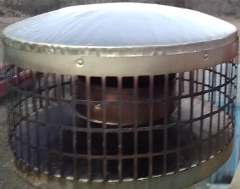

In any case, bikeshopguy345 may still want some form of screen up there, to keep those curious squirrels out. Just something coarse enough to avoid any likelihood of clogging (think 5/8 - 3/4 inch mesh). A bird in your stove is a sad day, but a pissed-off and soot-soaked squirrel in the stove is the day you may need all new carpet, drapes, and furniture.
My homeowner's insurance requires a spark arrestor. Even if they didn't, I think I would leave it for critter protection.
Yep, the question is grid size. I did some research on this way back in 2012, and from my decade-old memory, I see to recall most insurance and/or state requirements call out 5/8" or 3/4", hence the numbers I posted. Unfortunately, some cap manufacturers choose to use 1/2" or smaller, it may be less expensive. The smaller grid size is more prone to the clogging you had experienced.
Do your own search on this, don't rely on my old memory, but I suspect an increase in size may be a benefit for you.
Good to know! I’ll measure it when I get up there again for spring cleaning. It is Duravent and from what I can tell online it is 1/2" mesh. My insurance just calls for a “UL listed spark arrestor." Modifying a UL listed product may render it no longer UL listed?
Either way, I just plan to keep an eye on it. I think it'll be fine now that I won't be using random junk from the recycle bin for fire starting.
Yes, I do believe modifying it would invalidate the UL listing. In that case, if it continues to cause you problems, you may have to shop for another UL listed unit with a larger size mesh. No sense in messing around with your insurance.
I haven't had near the buildup issues you've had at the cap, but here's what my Metal-Fab cap looks like. The openings look bigger, but there's also more surface area for stuff to stick to since it's stamped out of a flat sheet of metal vs. the hardware cloth looking deal on yours. I think you'll be okay with some burning habit changes like you've mentioned. I can only imagine what your cap would've looked like with the BK you were originally considering :)

Last night's fire was an exercise in frustration, but fortunately things ended well. At about the 1hr/300F mark the fire kept stalling out. The damper was almost closed at 300F so I though my new adjustment was starving the fire for air. I decided to remove the foil tape from the flapper to give it more air. I do no recommend using foil tape! I ended up using a pencil to just poke a hole in it. I think a small magnet would be much easier to deal with for covering holes on the damper.
Removing the foil tape did nothing. I decided to prop the damper fully open with butter knife. I still couldn't get the fire to go! This has never happened. I sat on the couch feeling frustrated, confused, and wondering what I had done to mess up my stove. It was then that I realized that I must have some kind of obstruction because I kept getting smoke spillage when opening the door, which has never been a problem before.
Fortunately last night the moon was bright. One trip to the roof at 11pm confirmed my suspicions of a clogged spark arrestor cap. I popped it off and by the time I was back inside the fire was already going. Things seemed to burn well and eventually stabilized around 500F. At midnight threw one medium split in and it peaked at 750F and I went to bed. The stove temp was just below 200F and there was a small pile of hot coals in the back at 9AM! I'm counting this as a victory! I think the damper is closing between 300F and 400F but I'm not entirely sure yet.
I am still looking forward to doing a cold start to coals burn time test, but will have to wait a couple of days for cooler weather again.
When we first started using the stove we used a bunch of junk from the recycle bin to start fires. Cardboard, glossy mailers etc. I think I must have disturbed enough ash in the system yesterday finish plugging it up. Still crazy how it went from seemingly over drafting to clogged so fast.
Now to go clean this mess. Any suggestions?
That's a fine mesh cap for a wood stove. I think I would replace that screen with one with larger holes. It looks like 1/4" or 3/8" mesh. Remove that screen and go up to a 1/2" or 3/4" mesh.
Nice work! Glad my experiences could help some. There did not seem to be a ton of information online about this stove when I bought it so I have been trying to document what I can for other current/future owners. Thank you for getting pictures of the chain/damper/bimetallic coil setup while you were in there. It sounds like you are in good shape now with the heat pump not kicking on for a night like that, in your climate.
