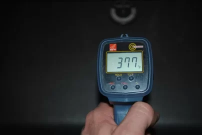

Stove top temp just before 12:30am.

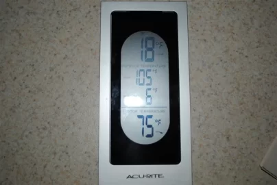

Room temp at 7:50 am.

Stove top 8:00am

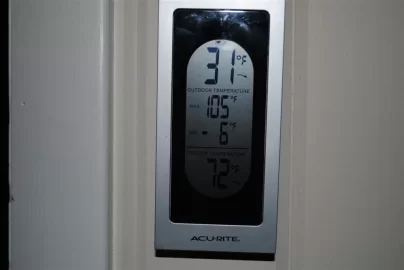

Warmer here tonight so won't be running the fans, hoping to get enough out of this load so I won't have to load in the am. If I have to load tomorrow right after work that's fine.
Notice the outdoor temps and just about flat indoor temps over the 24 + hours, I'm heating a 2 story house just under 2K. Indoor temps are taken from the kitchen counter which separates the family room from the kitchen about 18' from the stove. The master bedroom is at the end of the hallway upstairs, temps in there last night were 64 and when I woke up they were 64.(L shaped staircase make moving air up the stairs tough, don't really try anymore) The hallway leading the the stairs where the thermostat is stayed at 70 the full 24 hours.

All the splits I've used are pictured above. Last nights load had 9 splits and a little filler piece, these are not what I consider large splits. I didn't load this morning, I'm hoping that load will make it 20+ hours.
On the thermometer pictured above it shows room temp and outdoor temp(sensor on my deck) during the 24 hour period.

Thanks rdust..................That's valuable Real World data that we can all benefit from...................Especially fer dem BK fearin folk ;lol
