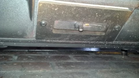

Hi. My 2550's primary air flap does close all the way. I actually hear it click. The problem is that the flap itself is about 1/4 inch too small from the bottom lengthwise. This leaves a gap when fully closed. Does your primary air flap cover the entire opening or does it have this gap? Thanks!
I'm pretty sure on the 0028 the flap closes all the way, but there is still a gap at the bottom, much like the Defiant.
Strange. My defiant doesn't have a gap. The flap covers the entire opening. The problem was that it had been springing back from closing completely which I fixed.
Strange. My defiant doesn't have a gap. The flap covers the entire opening. It had been springing back from closing completely which I fixed.
Mine has a gap. It closes completely, but the flap does not cover the entire opening.
Also, where are the secondary holes on the Defiant?
About 4 inches behind the front legs in the ash pan holder right up against the side of the holder. You can feel around for them and find their indentations. Use gloves if hot, obviously. :)
I finally got a chance to get back there and take a picture. My encore looks like it closes completely?
