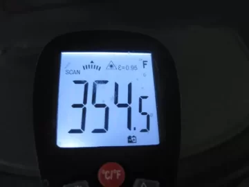

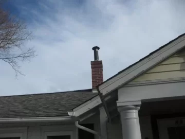

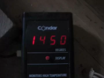

I attribute some of the clean burn and low temps to the new Condar ceramic cats I installed recently. Here are a few pictures of the 1945 as it is currently burning:
  • [Hearth.com] 2013 VC Burning Thread
