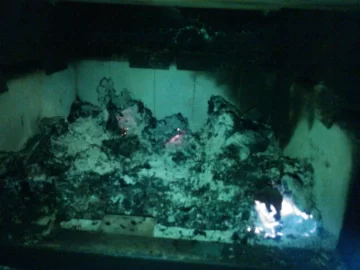

Just rake the coals before you load up, preferably more toward the front where they'll burn down faster and open stat all the way until they burn down. If the house is cooling off too quickly, just stall a while longer on burning them down; load her up and let her run! Just be careful when loading next go around, those coals really pile up and last longer exponentially. You may have some unwanted visitors roll out on your hearth if you aren't carefulWhat do you guys do when you have lots of hot coals but not enough for a cold overnight burn and you want to go to bed?
