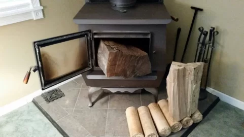

I promised photos of the load I would leave in the ol' King as I walked out the door for 3 weeks to New Zealand.
As you can see, ONLY a King can handle this load! First piece in was 57lbs of black walnut 4 years old and 16% (yes I did a fresh split off one side) Next an 8lbs piece of silver maple followed by 6 NIELS.
Hope it's still burning when I get back!;)
Ah. Man of his word.
So if that piece went into the King technically it should go into a Princess?
Anyhow, enjoy your trip and don't forget to watch the movie 'Once were Warriors' on the plane.
Holy. Crap. I'd be afraid she'd stall...

I have some rock maple that is AWFULL to split. I see me making a few huge chunks like this.
Sitting in SEATTLE....Come on PATS! Anyway, I used a 28 ton splitter to "size the walnut". It won't stall, it even took off with fresh load of new smoke to eat.
I think I'll be using an echo 670 to size mine.....
