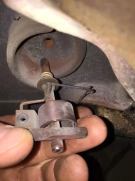

Question on Vermont Casting Encore 2550 primary air control.
My stove's right side lever controlling the primary air no longer adjusts the primary air.
The regulator has been fine for the last 10 years.
Something is now disconnected or broken.
Maybe it's a wire, maybe more.
It looks like I need to remove the right-side interior plate, called "Right Air Plate (Inner side)" , to examine the lever backside, called "Thermostat Assembly".
--> If I need to look at the "primary air regulatory system" underneath the floor of the stove, will I have to take apart the rest of the interior plates of the stove apart to get at it?
Thanks in advance for comments and experiences.
I'm referencing the 2550 manual, page 34 onward, copy at
http://www.appliancefactoryparts.com/content/pdfs/171411-1.pdf
Potential parts: (diagram #)
(#39) Thermostat Assy 5005470
(#43) Primary Air Regulatory System 5000337
Not likely parts: (#42)
Primary Air Frame 1307411
Primary Air Valve Only 1307412
Primary Air Rod Only 1601493

Can you see the wire attached to the primary air flap in the rear of the stove (maybe came loose)? Removing the right inside wall will give you a good indication of where it broke. There is no way to actually see the wire that travels under/through the stove (would require a complete tear down) but the wire can be change pretty easily without a tear down. If the break is out of site you can probably snake the new one with a thinner coat hanger or a flexible snake.
*found some pics of my full tear down last year
